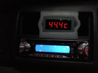

I actually managed to win on a £6.19 bid one of these.... http://www.ebay.co.uk/itm/Digital-Red-C ... 35b3b68f8d Cheers Kirsty fer pushing these in my direction... =D>
After a fast send.. I've smoked the screen.. (Too red even when off, ignore the picture.) Expect a pimp soon! :D

Post by jaylee » Fri Jul 29, 2011 11:01 pm
missfixit70 wrote:It's a bit of a bugger to get into (shouldn't be a problem with your girly hands :wink: ), but I've done a few now on the metal top hose connection coming out of the drivers side using a jubilee clip & a small ratchet with 7mm socket to tighten the jubilee, gives a good indication of coolant temp. I wouldn't put it on the hose itself, apart from possible chafing, it will have the insulating properties of the hose itself to contend with.
Think i've found my vocation.... :mrgreen:
Fitted & working! 8) Just needs the dewbury to arrive to hold it in the 1 din hole... Currently wedged in with the packing it came in... :roll:
... it seems to adjust brightness to the lighting conditions too! 8)
missfixit70 wrote: I'm sure your installation will be much neater than mine :wink:
Close... But no cigar.. :lol:

Looks pretty nifty jaylee =D>
Where did you finally manage to fix the sensor?
Steve
jaylee
Posts: 5500
Location: AQVAE SVLIS
Re: DIY non invasive temperature gauge probe placement ideas
Post by jaylee » Sat Jul 30, 2011 12:19 am
widdowson2008 wrote:Looks pretty nifty jaylee =D>
Top metal hose attachment coming off the engine with a jubilee Steve... (But not too tight, don't wanna crush the sensor.?) Haven't had a chance to give the Bongo a bat & run up to temp as yet.. Walk to work..
Should look right when the 626 clock/cubby unit shows up... & a little modding! :wink:
