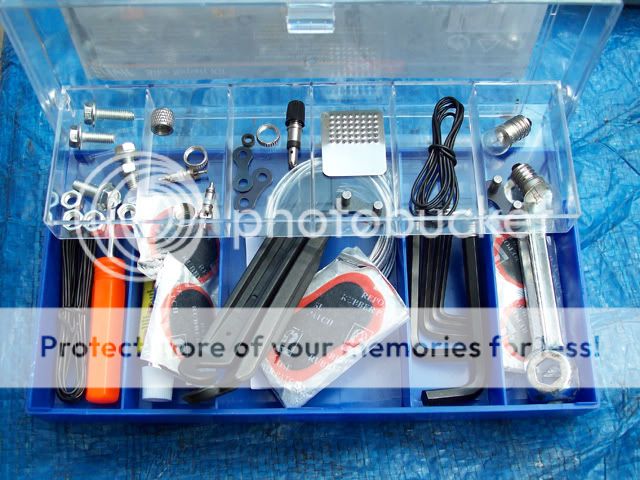

We took a basic cycle repair kit

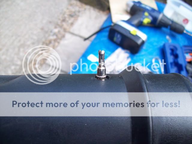

Selected a valve
Discarded the valve cap
Drilled a 3mm diameter hole through the valve
In the position of the original stub, drill a hole 4.5mm diameter through the pipe wall
Using a pair of pliers to hold the valve, screw it into the 4.5mm hole (the valve will make its own thread in the plastic pipe).
The plastic air pipe is thicker at the stub location so the actual thread is about 5mm deep.
and hey presto - a VERY rigid stub.

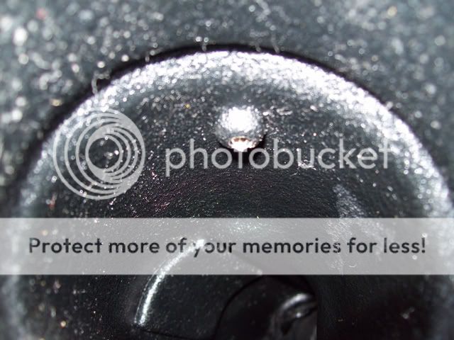

.......and a view inside the pipe

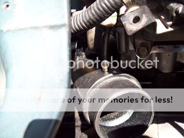

Air intake pipe with hose fitted viewed in the Bongo from the driver side

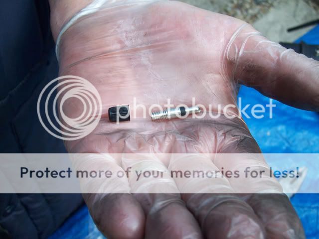

Selected a valve
