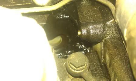

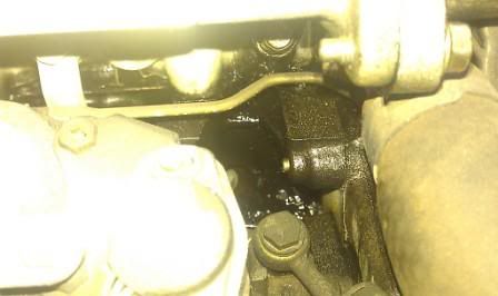

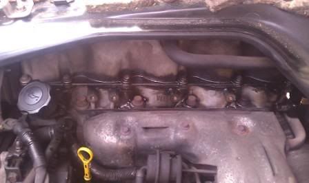

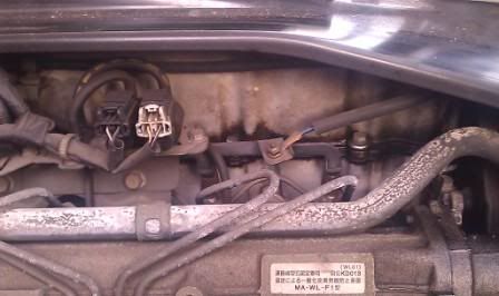

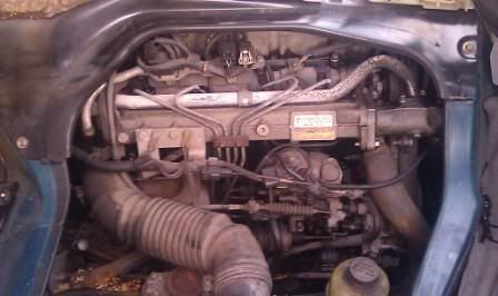

Thanks guys it would appear the common thought is that the gasket is ok but I will need to get the oil leak on the intercooler and pump leak attended to.
Below are some pictures of my block and rocker cover so you can see the problem.
View of rocker cover from passenger side.
View of engine from drivers side.
View of rocker cover from drivers side
Oil on block on drivers side
Re: Back from services but needs more work
your engine in pics looks just the same as mine! As others have stated before, my rocker cover also weeps a little, the gunk from the EGR the same, and I have today just replaced the top pinion seal on the power steering, which as stated before drips onto the intercooler. The intercooler is only air-fed, it cannot leak fluid, so from under the bonnet, follow the steering column down until you can peep under the rubber dust cover below the UJ. Bet it's that leaking. Good luck getting it sorted, always a worry, Bongo's.
