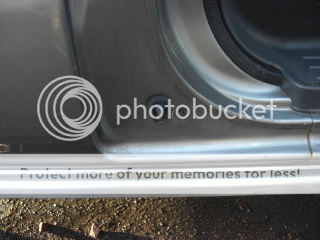

As per the previous two responses for the first three of your problems. Check your door switches are working for the other.
Driver's side one shown here.
