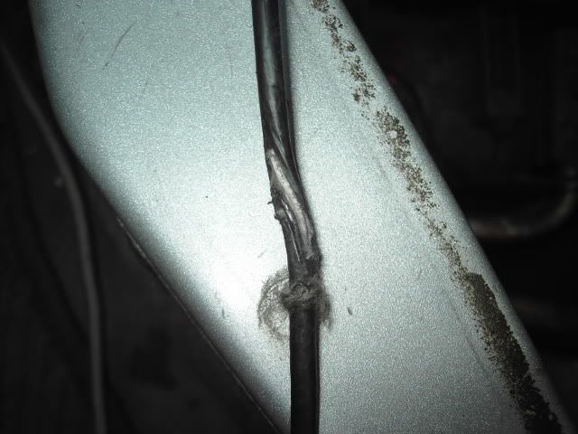

I did notice this wire from your wonderful temp gauge and presumed it was damaged when the belt broke. It was all working well up to now but i did move the cable to get my fuse murdering hands in there.

That temp gauge cable is a write off....unplug it from the back of the display unit.....unbolt the other end from the cylinder head and send it back to me ....I will try and fix it.

haydn callow wrote:That temp gauge cable is a write off....unplug it from the back of the display unit.....unbolt the other end from the cylinder head and send it back to me ....I will try and fix it.
Will do Thanks do you think that was the cause?

by haydn callow » Tue Mar 22, 2011 7:19 pm
Possible but I doubt it.....remove it before trying again.
