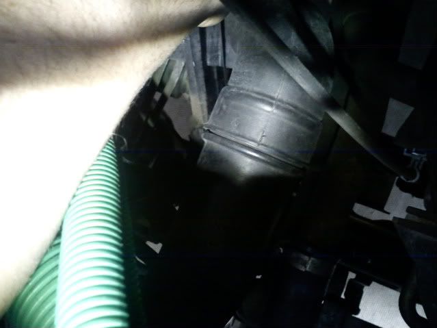

I've just been out and measured my rod :shock: [-X So you have a rough point of reference Bro... I'm showing 3 and a 1/2 cm from spline end to mount flange.
That must surely have been the trickiest picture i've ever taken...ruler in left hand,phone in right hand, and a gobfull of torch! :shock:
