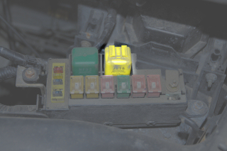

under the bonnet in the small fuse box, some models have a pair of relays,marked on top of the fuse box, fitting kitches/leisure circuits for some strange reason seems to affect the switch off of the main relay,most commen cases are the later shape V6's but i have seen it occur on others

Hi Julian this relay may be the problem, at the moment the auto electrician cannot find the fault, I am going to get a set of CD wiring diagrams to help. What he has found so far is sometimes when the ignition is switched off there is a draw of about 0.5 amp ,but not every time, if the battery is disconnected and then reconnected the draw goes away. He also said that sometimes the light on the heater panel will stay on when the key is removed. This is all too much for me so I hope he can sort it out. the Bongo is a 2.5 diesel. Any help would be very useful. thanks
