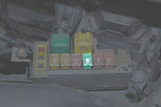

Hi I have been working on my girlfriends 96 bongo and I have been putting in a leisure battery and I have followed all the great guidence on here (saved me a huge amount of time!)
I have cut the 2 wires behind the fusebox connecting the top row to divert them to the leisure battery but on testing the lights (with no power connected from the new battery) the fluro light will still come on if the doors opened and if I switch it on also.
I had no power to the side door release with the wires cut and the stereo was dead also, thats all I tested to see if it had knocked the power out.
I then reinstated the original wires and tested the same again and the door and stereo worked fine again so I turned the light on and went through the fuses pulling one out at a time and it stayed on! I went through all 2 lower rows and nothing made it go out. I left the 2 relay/reseting looking ones at bottom right and left as I dont know what there linked to or if they were fuses!.
I found some pretty poor wiring that I pulled out (what looked like jap twin and earth minus the earth with no fused connection to the battery that had been cut and not disconnected or had the ends properly finished so there was a un fused live just stuck up in the dash :shock:
There are no added connections (now) on either of the batterys so I am totally stuck and Im thinking I have missed something can anybody help me out with some words of wisdom??

Fuse No.1 (10A) is cabin lights (I think).

I just put the front 2 lights on (by rear veiw mirror) and pulled fuse 1 top left and they stayed on too! :?: somebodys been tinkering with the wires me thinks! but where?

Top right 15A fuse 8.. What happens when you pull that??

Top right 15A fuse out and...........all lights stay on.

So they should do...! Thas for the radio, lighter socket, & mirror folders.. (If fitted.)
& you pulled widdowson2008's idea no 1 fuse 10A top row, far left...?

Yep tried it with both and they still work!

Yep 3 wires, white connection block.. One live, one constant ground, (switching on when door shut.) One ground to door trigger... Opposite side to exposed 5 or 3 contact pins (depending on if soft closure fitted to sliding door.)
Anther thought...? Maybe the light tied into the bottom 4 row on the left 15A, meant for the sliding door in some mad Jap re rout experiment..? :?

I have tried pulling them out one by one but I left the two pink fuses on the bottom row that look like self resetting fuses so I might try them tomorow but I think its time for some liquid thought!

The pink ones are slow burners... i think...? I only have one on the right, rear demister!

The wiring diagram is here for the cargo area lights;
Try pulling the larger fuse 40Amp fuse BTN under the bonnet, if this puts the lights out then suspect either a modification or a short across the top right fuse within the wiring loom;
If it doesn't then you really need to find out where that power is coming from and if it is fused !
