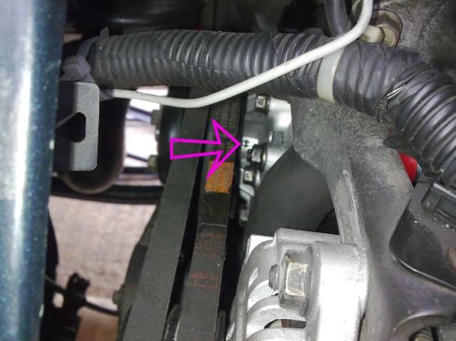

check for water pump leak when engine is stone cold and stopped ,you may find it weeps runs down the front of the engine and then looks as if the sump at the front of the block is leaking water,
you can push some kitchen roll around the tell -tale hole on the pump to see if it stains.

Do'nt know what to do #-o went for a run came back it's been sitting on the drive for a couple of hours now & everwhere is dry~even crawled underneath but no sign of water or dampness around the water pump.
Any ideas anyone please.
