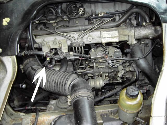

Bled bongo and realised the rad fans are not coming on. Even when hose is too hot to touch.
Could this be the cause of my hose burst blues?
Disconnected what i think is the temp sensor under drivers seat at rear near ATF dip stick
and the fans kick in straight away.
What to do next?

try a new switch baz.part number
mazda mb59318840a £36'54 plus vat
you could also get a new temp sender
mazda mkl011851x £25 plus vat.
fit them and bleed up(you should be good at that now eh.
if your struggling im at the bash with some second hand bits for display purposes,you could try a quick swap job with one of them.

Bongo nads wrote:Looks like a hose blockage to me. Immediate thought was thermostat, but in the middle of a 130km trip - unlikely. But I'd still be looking at the thermostat.
And don't forget my suggestion, that it is five times easier to bleed (and safer) using the the temp sensor port.
No it ain't in my opinion, tried it, still had to bleed it properly :roll:
How could the hose be blocked? I'd be very surprised, matrix or rad maybe.
Did it chuck coolant out when you opened the header cap? could be airlocked if you got pinholes/weeps (I've been dealing with them myself over the last few weeks :evil: ) That would cause the temp to rise & the fans not to come on, but get the sensor changed anyway & get a pressure test kit off Ady so you can check for those elusive weeps that cause all the problems.

I'm not suggesting you can leave the connector off the temp sensor forever more and run around happily knowing the fans may be keeping things cool enough baz... but i think in an emergency leaving the fans running would be a safer bet than leaving them off in your case. Initial thoughts? Airlock.
