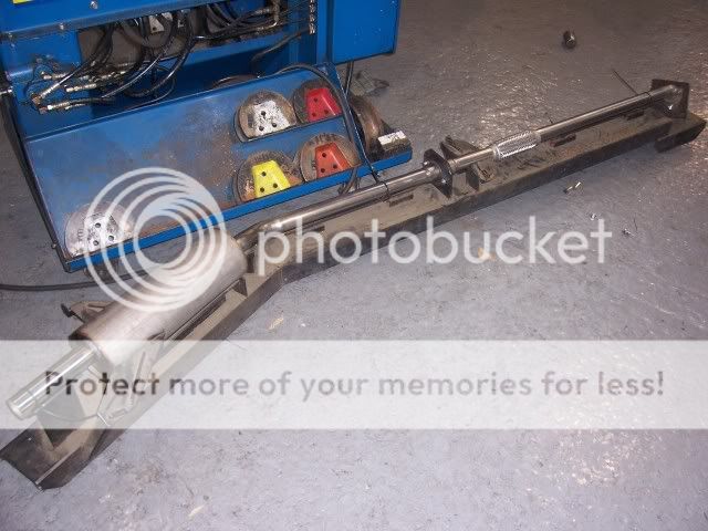

I got mine delivered from MIJ. So far so good.
Having said that I noticed large flakes of rust on the welds for the flexi section. :shock:

brorabongo wrote:http://www.mijperformance.com/exhaust-mazda.html
if theres rust around the flexi section chances are its made of mild steel or they welded it up
using the wrong filler wire :shock: stainless wire isnt cheap
u can test it with a magnet
