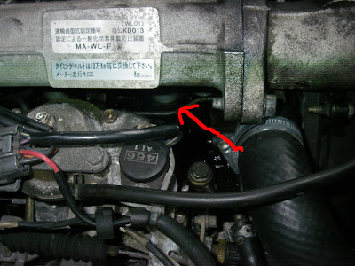

I am nearing the end of the huge job of fitting a new cylinder head, and I cannot remember where this pipe went!!
It is a metal pipe running from the front of the engine, runs under the inlet manifold (has a bracket that attaches to the inlet bolt)and then has a rubber length of hose joining it.
Please can someone tell me where the end should go!!
Adam

if its the one i think you mean one end connects to the steel pipe that rises up to the vaccum switches/solenoids that control fast idol speed etc they are on the top of the head in front of heater plugs.the other end dives down to steel and bolts on to the front edge of the injector pump heading towards the vaccum unit ,which makes sense as it is a vac pipe hope this helps.

the soleniod switches i mean are the ones in front of you high up half way along thi lenght of the head,one has a black plug the other white.behind these is a little plastic Tpiece the rubber pipe goes on there
