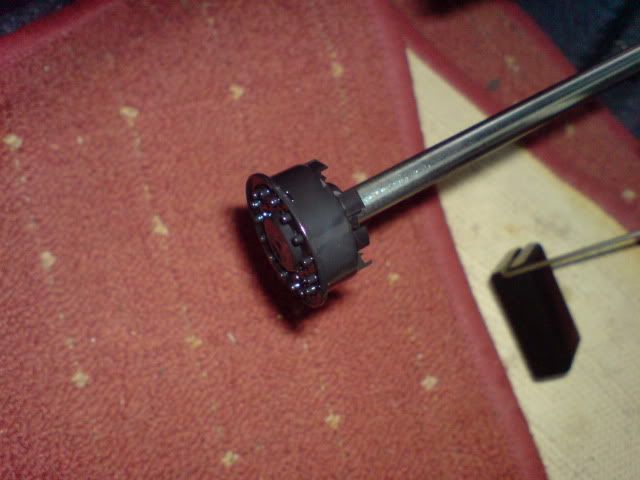

Something I've not noticed before on that diagram, part 42-113 'FILTER,FUEL TANK'. It can be seen at the bottom of the pick-up tube in the top left hand section. There's another pesky filter that may become clogged over time :( . It's probably quite a coarse mesh filter, but still a potential problem area.

Post by missfixit70 » Sun Apr 04, 2010 9:41 pm
It's not much of a filter, it's just a plastic jobby, but it's not unknown for the pick up to get blocked if you get crud in your tank. If it does get blocked it can usually be cleared by blowing back down the fuel line, but obviously it's best to remove aything capable of obstructing it from the tank.

Post by Simon Jones » Sun Apr 04, 2010 9:48 pm
You didn't have to go outside at this time of night to strip down the fuel tank - it could have waited until the morning :). Is there anything Bongo related that you don't have a picture of?
Re: erratic idle
Post by missfixit70 » Sun Apr 04, 2010 9:53 pm
:lol: Plenty I'd imagine, just happen to have checked all my sender etc out before starting on floor fitting :wink: I'll be replacing the short lengths of fuel hose as a precautionary measure, after all the fuel supply hoses are supposed to be changed evry (4?) years I think on th service schedule :wink:
