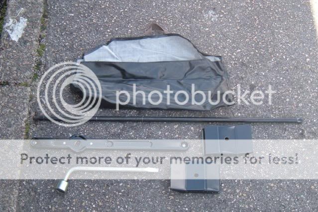

Tools should be in the locker thingy on your side step. The long rod is clipped to the top so if you can't see it, feel for it.
Long rod and short bar make up the wheel removal kit

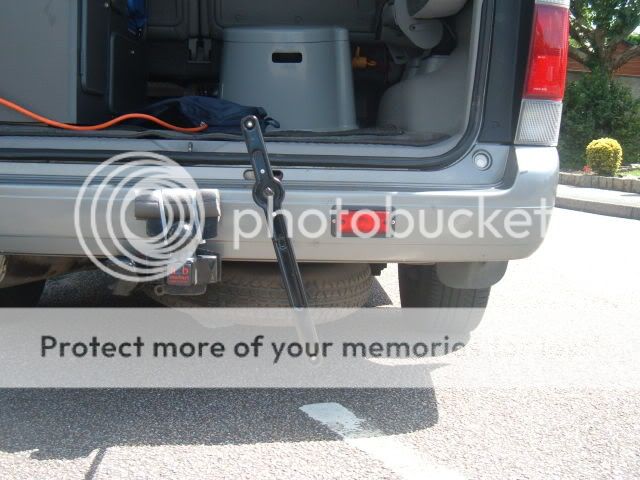

Insert rod and bar into hole as shown (may be somewhere else on the newer Bongos but principal is the same - is yours newer?)

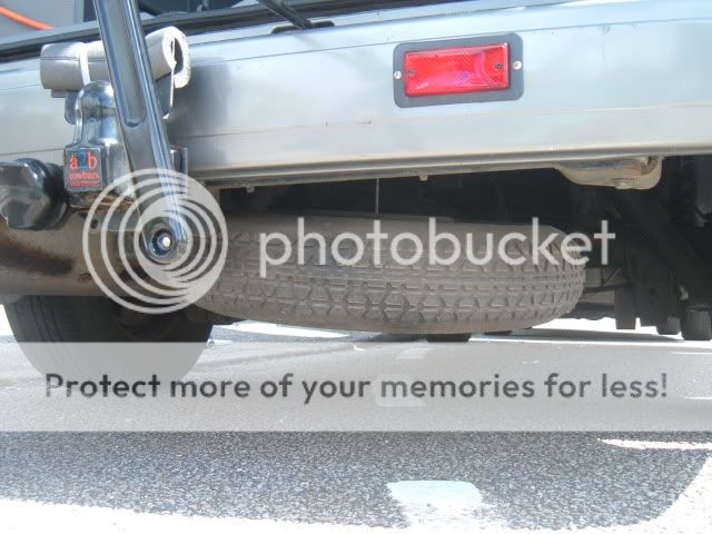

And wind to lower wheel.

Aaaaargh Alison, its a dreaded space-saver. You'll have to tell him about the facts of life when he gets older :lol: :lol: :lol:
