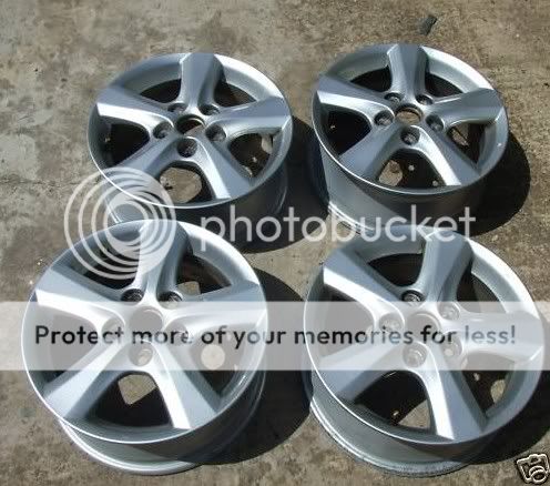

My Bongo came in from the Land of the Rising Sun with 195/80/15 mud and snow tyres on.
They are very 'bouncy'!
Now I've got me some alloys and I have got hold of some 205/70/15s
Anyone got this size? They work out around a 1% greater circumference that standards......but they are new and very cheap!
Oh alloys! What do you think?

are the alloys off a mitsubushi fto??
dont forget to get alloy wheel bolts as steel wheel bolts will not do the job due to the way the bolt fits upto the wheel

Dunno :oops:
Advertised as Mitsubishi alloys...£75 :shock:

Hi,do you have centre caps for your alloys?
