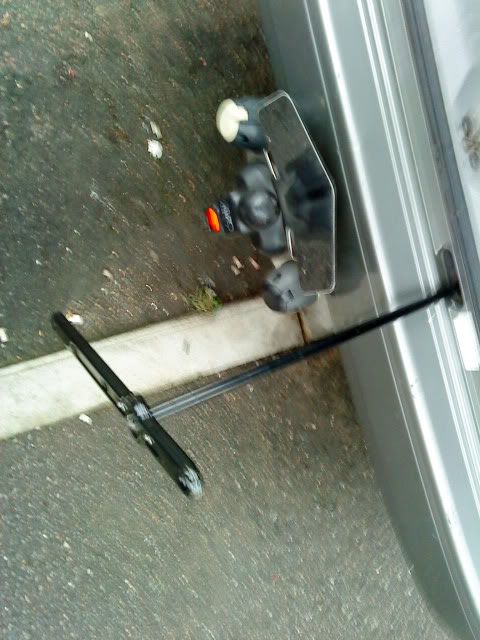

Insert long rod into rear bumper locating release catch then with your rachet out of your wheel kit wind down spare.

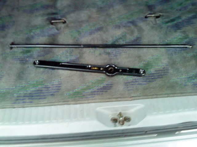

you need these two bits

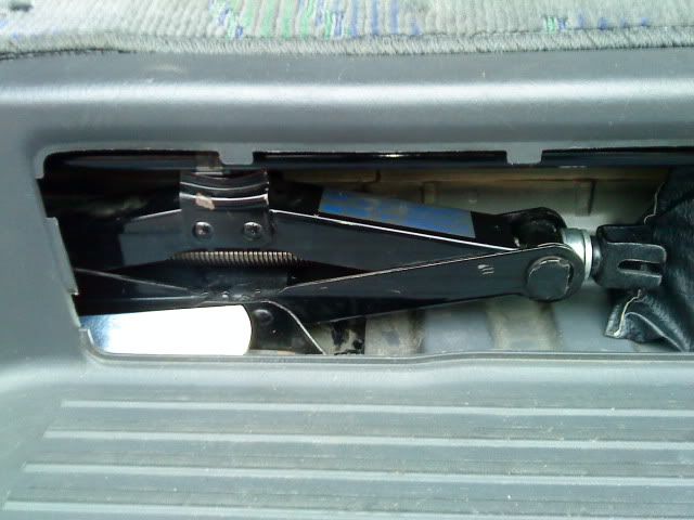

the long rod is clipped to the top of where the jack is
Put the long rod into hole in top of bumper then put rachet on end and lower the spare wheel
