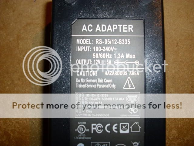

thanks to replies so far this is what is used in the home to power it
Re: 19" tv dvd ombo from aldi
In that case, you can power the unit without this converter directly from the battery.
What I would do is:
1. If you can find an identical plug to the one on the TV end, (Maplin?) get one and wire it to a car cig lighter plug. Your TV is expecting 12v on the centre of the plug. Car cig lighter plugs are also centre positive.
2. If you can't find a suitable plug (unlikely), get a car cig lighter plug and socket, and wire these in line to allow you to disconnect the cig plug from this adaptor and transfer it into the car cig socket. I'd cut the cable fairly close to the 240v adaptor, wire the socket in there (centre positive) and use the remaining wire with a cig plug to run the TV in the bongo.
Question for those in the know - will the Bongo rear cig socket be OK at 1.5a?
This ac adaptor can only kick out 1.5a, so the TV must only draw an amp or so in normal operation.

It looks like 12 volts at 5 amps not 1.5 out of the adapter.
I would be looking at powering it off a leisure battery unless I could promise myself to use it for short periods when the engine is not running.
Good spot Tim,
1.5a @ 240v, 5a @ 12v, so the cig socket needs to be capable of running at 5a.
- unfortunately won't do as it is only 1.5a output. There is a 3a version which might do if you are lucky.I would invest in this - Maplins Cigarette Lighter to 12v 1.5amp regulated supply for two reasons
Ah, I should have read it properly, that wont do (well it might if you can get past the initial current draindave_aber wrote:Good spot Tim,
Also to note then that if you are using an inverter you will need at least a 350w one, I think Argos do a black and decker 400w inverter just shy of £30. but I would use your leisure battery (if you have one) to power it no matter what way you decide.
