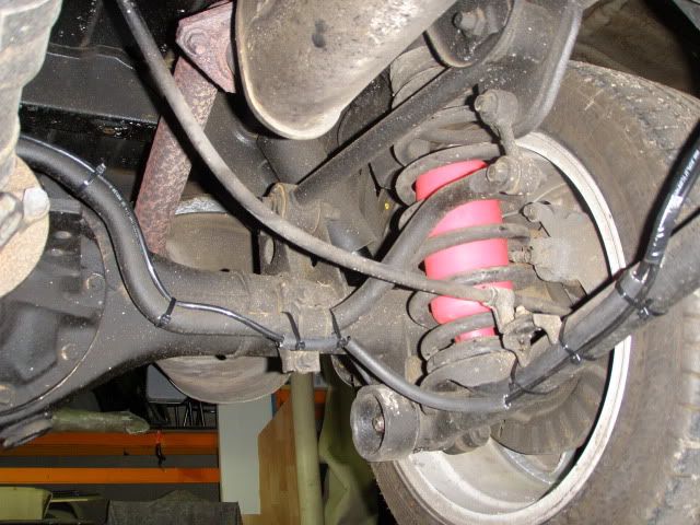

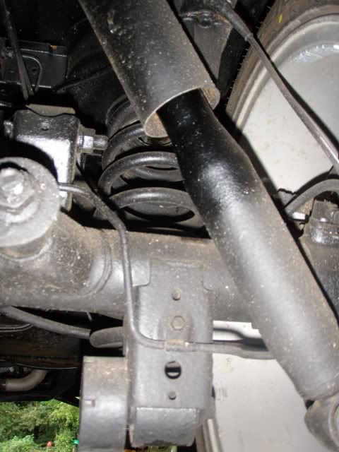

Hi there,
Well they've been fitted today, I took the advise and ensured they were fitted with the valves facing downwards.
Fred at discount truck did an excellent job again and fitted them with care and attention to detail.
On each side he removed the lower suspension so it was easy to clean and insert the bag from underneath. All the air lines have been carefully run to the filling points in the inside step. Anywhere where the hoses could have rubbed have been fitted with a protective sheath.
Initially running at 15PSI, so far the ride seems a bit firmer and less roll. Will experiement with different pressures but suspect what I have is pretty good, don't want too much as it would be like a pogo stick.
Pics below:
Before:
After:
Now looking forward to not wallowing and bottoming out at the slightest bump.
Not sure whether to have the drivers side slightly higher in pressure due to side conversion.

Re: Air Suspension
great news, you won't miss the wallowing and the dreaded bottoming out, but you will enjoy the new firmness and road manners. Ride height should be set level using a measure to wheel arches and adjusting pressures to suit.
