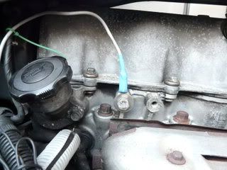

We tow a 900kg van....no problem at all...however a point to note....I have a TM-2 temp gauge fitted with the sensor on the "exaust" side of the cylinder head....Without the van it reads between 95/105 C....with the van we read between 100/120 C....the highest with the van has been 122C.....Not a problem and the Bongo gauge is still spot on 11 o'clock (bongo sensor on inlet side.)
When I had the sensor for the TM-2 on the inlet side under a rocker cover bolt the highest temp attained towing was 108 C.
I think I may move it back to the inlet side. makes no differance to what's happening.. but less scarey.

What would be useful for the TM2 owning community is if a standard/recommended fixing position was agreed and used so that some kind of standard indicators of normal and abnormal behaviour might be arrived at. Maybe the TM2 fitting instructions could recommend a position, to encourage it? Mind you, I can see that it will still be difficult as ambient air temperatures and variations in airflow over the engine would also influence the temperature at the engine block surface. It's this kind of issue that makes me think the Mason alarm is in many ways a better way to monitor engine temperature, since it uses the standard sensor immersed in the coolant. It is interesting to reflect that human body temperatures are measured by trying to place the sensor nearer to the bloodstream and away from any exposure to surface or extremity effects.

We already do have a recommended position and we provide a correct sized bolt.
However as I say earlier...when towing this position does read a high temp.
