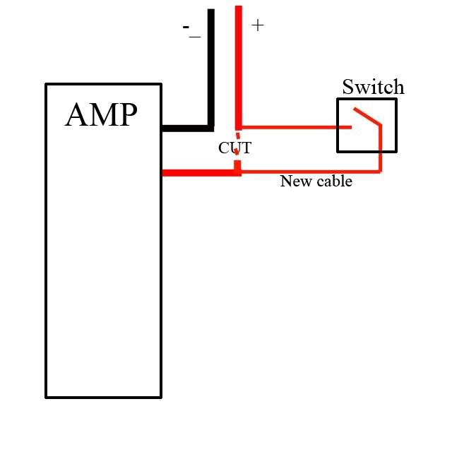

I'd look for the power feed to the amp, and disconnect it/put a switch on. See if the battery lasts longer.

Maplin in Plymouth have these that would do
http://www.maplin.co.uk/Module.aspx?ModuleNo=42949
You need a length of two core cable, to take 16A? (depends how many watts your amp is).
Can you crimp connectors on a wire?
If so, cut the voltage feed wire to the amp, (with power off to it!), and use the two-core cable up to (say) where a switch blank is.
This switch needs a 12mm hole - drill a blank to mount it. Crimp a spade on each of the wires at the switch end, and crimp, straight connectors on the other, fastening it to the cut power wire.
SD

thanks for that sounds straight forward so all i am doing really is leaving the main power cable to the amp in place and just spuring off it to the switch is that right??

You need to cut the power (+'ve only) cable, and put the switch across the cut wires.
As you need to extend the wire to the dash (or wherever), you'll need some 16a two core cable. Maplins will have a crimp tool (few quid) and all the connectors.
