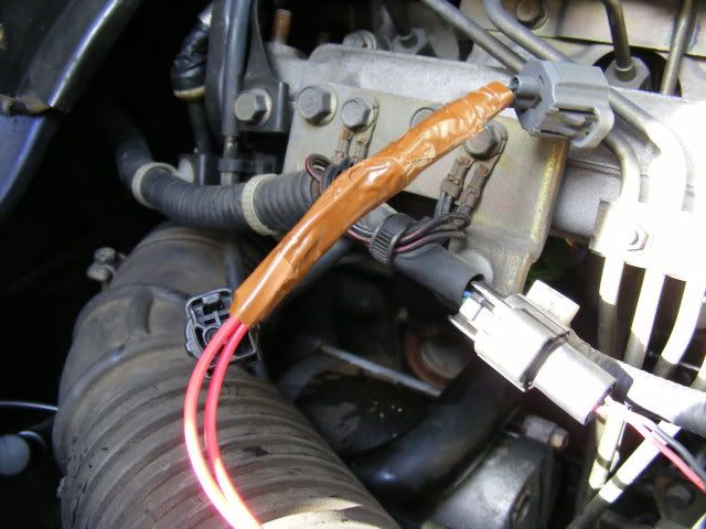

Nothing ,not even my radiator fan came on, he said its the sensor, he had one in stock, £12 but he said do it myself, because it has to be done when the engine is cold. and told me to fit a switch to override the fan sensor if i thought it needed help to cool down the engine. the switch does the same job that Bigdaddycain has posted about, by unplugging the wires.
I changed the sensor using a 19mm long socket and an extension rod, otherwise you cant get near to it using a spanner. i also had to take the air filter pipe off to give me more room, you have to do an instant change over ,as the coolant comes out quite fast. i put about a half litre coolant back in the header tank after i had completed the job.i then cut into one of the wires (does not matter which one Mike said), extended them and fed the wire into the cab and fitted the switch in a handy place. I ran the engine up to temp for a good half an hour then switched the fans on ,the temp came down very fast. sorted.

WIRES EXTENDED FOR SWITCH( dont worry proper connections ,not scotch blocks, and then taped up)

Excellent Dave - I like the sound of that arrangement a lot. It also confirms my suspicion that ageing sensors may fail and you don't realise it. I wonder how often this could have been a contributory factor to an overheating (well, boiling over and spitting coolant out the header tank) issue. It makes me think it wouldn't be a bad idea for anyone in doubt to fit a new sensor anyway - how much did the sensor cost if it isn't rude to ask?

I have done it the way Mike at wheelquick told me.Lewy wrote:Daveblueozzie - would you clarify the wiring of the switch please for a dunce - you say one wire but wouldn't you have to have to cut into both wires coming out of the plastic end of the sensor i.e a loop or circuit and then put a switch in there for the cab? Sorry a bit confused
you cut only one wire,Mike said it does not matter which one, you connect one wire to one cut end, and another to the other cut end, you then take the two wires you have connected into the cab and connect them to a simple on off switch. you don't need a power supply all your doing is switching the current already in the original wire to either on or off. with the ignition on or the engine running you can turn the fans on or off as needed, if its in the on position the sensor takes over the control, if its in the off position the fans come on and you control them,by putting the switch to off position its like cutting the power as if you had unplugged the wires. Mike did say you must turn them back to the on position before you turn the engine off. that's it simple. it has to be simple for me to do it.
