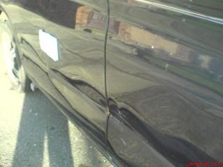

This happened to ours back in November and cost in the region of £1500 to repair, a new door.
Wasn't harry breaking his silver Bongo down recently ? anyone ?
James

james1508 wrote:Image
James
Ouch..! My Bass player put a similar dent in mine just before Christmas 07.. But missed the door!!
It kind of pushed in on the door pillar & dents the panel out at the back.. (just under where your hook up socket is James.)
In fact looking at yer pic again, the dent is identical bar a slight scuff on my door.. (mines mono colour black too!)
My quote cost him £500.. Which he dutifully paid up.. :D
Had the work done by the same body shop firm that did a great insurance job on my old Combo van when some fool stove'd into the back of me. & they know Bongo's too!!
Hope you get it sorted Longo.. good luck!! :D
