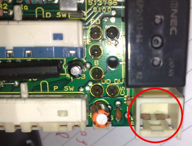

after the last fix i did on the window switch its started playing up again, which coincided with me leaving the window open in the rain. up untill that point it was working fine
i opened it up and these two contacts were pretty badly corroded
i only though of taking a pic after id cleaned them up but it seems to have done the job.
might be worth a lookie if your switch is behaving badly
note to self: dont leave window open in the rain

That looks like the bit that isolates the passenger side? I had exactly the same problem, with the same cure, well done for putting the photo up, I didn't think at the time #-o

How did you clean the contacts Meek? Access looks a bit limited...

I used a rolled up bit of fine wet & dry, when i was trying to repair my original switch.

bigdaddycain wrote:How did you clean the contacts Meek? Access looks a bit limited...
i found a little tool in work that looks a bit like a dentists scrapie hook thing, i used that and it seems to have done the trick

Generous coating of silicone grease before connecting any connectors will prevent corrosion damage.
