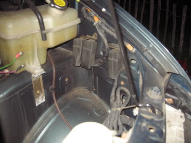

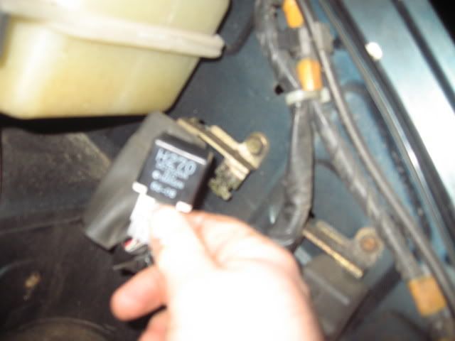

Post by brorabongo » Tue Sep 02, 2008 9:41 pm
AFAIK mine is just beside the coolant tank on a fitting bolted to the inner wing. It will have a rubber cover over it, and it looks like any over spill from the gutter below the screen would drip right onto it. You pull the relay inside its cover rubber down, and it should slide off the fitting. If I mind right the relay is something like H270. there might be a few of the same relayson the same fitting, so worth maybe swapping a couple about and see it that makes a difference?

Post by brorabongo » Tue Sep 02, 2008 9:42 pm
Found them :roll:

OK, been looking into this tonight :roll:
After much head scratching and rummaging (I've only got one relay where Brora's shows three... and that is for my front fog lamps....) It turns out that, YES, it IS possible for both front lamps to fail simultaneously :evil: :evil: :evil: :evil: :evil: :evil: Really don't know why....
