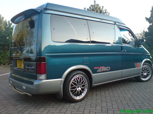

Post by bigdaddycain » Wed Jul 23, 2008 9:47 am
Yes, that could indeed be the case...We needed a paint code for daveblueozzies freda,and had issues obtaining the correct code.
If my memory serves me correctly, there are four shades of neat green, (according to my paint supplier). The only definitive way to be absolutely certain that the shade is correct, is to break out the colour chips, and offer them up to your bon...sorry, freda, till the correct shade is determined. I'd suggest trying the chip against a few different panels, in case vehicle has had paintwork carried out in the past.
A word of warning though, if you pick the "correct" shade in bright sunlight, you will have the correct shade on your vehicle in bright sunlight,conversely, if it's a grey gloomy day,the coulour will match on grey gloomy days, try to pick an "average" day with regards to lighting.
I needed some paint mixing for my driver's door, and freetop, see how it's a darker shade in failing light, yet matches perfectly in bright sunlight?
Failing light, (door and roof)
Bright sunlight... (sorry, no drivers side view in the sun)

Post by glitter1007 » Wed Jul 23, 2008 10:38 am
Thanks for your help - I will start my mission next week. At a festy this weekend in my lovely freda. By the way - love those wheels. :)
