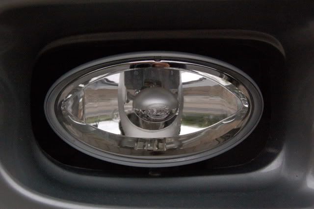

Checkout the Hella site, there is a catalog you can download with all the dimension, you should find something to fill the hole. I fitted these to my 97.

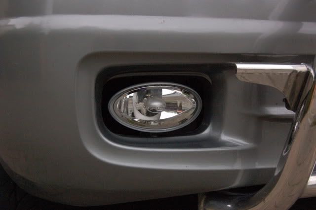

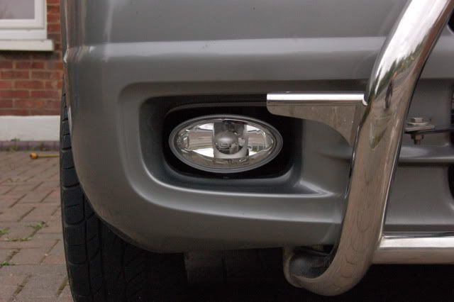

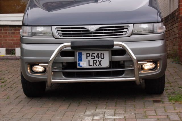

Hi keefysher, I guess mine's more like yours at the front with an extra trim thing at the bottom (pic), and I guess it leads to another question which was if you can get bullbars to fit, which I haven't got yet. Were they easy to get hold of? I like the idea that doing it that way if there's no cutting and, quite keen to have some angel eyes as well, sorry if I sound like I want I want, but they look the biz ;)
Re: spots on a new shape
Post by missfixit70 » Sat Jun 28, 2008 1:57 pm
It looks like Keefy had to cut the bumper to fit the bars, they are from an old shape, I don't think there are bars factory fitted to a new shape, don't know if the mounting points had to be modified/manufactured either. Personally I like the lines of yours & would leave well alone - other than fitting spots & fogs of course :D Simon Jones had some nice narrow spots for sale at the bash that should fit in the two lower middle slots in your bumper -very reasonably priced too :wink:

Just been weighing up your pic anne, if you wanted to keep the valance on your bumper, AND fit the older type bullbars, then a couple of 4-5" holes would need to be drilled into the lower valance part of the bumper... After an hour or two's VERY careful measuring! :shock:
I'm still thinking of what fogs would work with the shape of the blanks on your new shape... :-k
I reckon a set of hella micro DE optical fogs, flush fitted into holes drilled into your existing blanks would work well... Subtle, and low-key :wink:

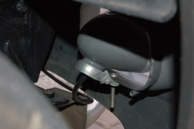

Dead easy, they use a single bolt but I spent a lot of time trying different mounting solutions and found this way the best
Some more pictures
I used a 626 front foglamp switch to control them but if you try this as well the switch must be wired to switch on negitive or the indicator light will not work. Also life's a lot easier if you also get the switch loom connector with 2" of the cabling to solder to.
