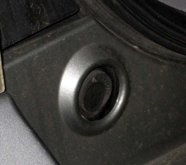

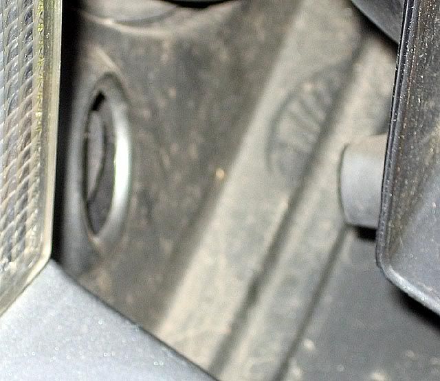

Get some of those little self adhesive rubber pads that you get a card full of in £Shops and stick 1 of the round ones about the size of a 2p coin in each of the 2 buffer holes in the rear trim panels.
They are just thick enough and have just enough squash to take up any slack between the buffer and the body and stop the tailgate moving.
Pictures to follow.
Pictures to follow.

scanner wrote:Get some of those little self adhesive rubber pads that you get a card full of in £Shops and stick 1 of the round ones about the size of a 2p coin in each of the 2 buffer holes in the rear trim panels.
Pictures to follow.

I think you may be onto something there Scanner. Either that or add an extension to the two cone shaped rubbers. Pads on the door frames sound a better prospect though and should stop the flexing at the edges. I'll give it a go.Get some of those little self adhesive rubber pads that you get a card full of in £Shops and stick 1 of the round ones about the size of a 2p coin in each of the 2 buffer holes in the rear trim panels.

Well I tried Scanner's tip and although I've only had the one short trip so far, it appears to have cured the problem. Well done Scanner, top tip and one for the archives I think Mr Maynard.
