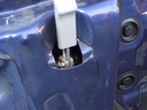

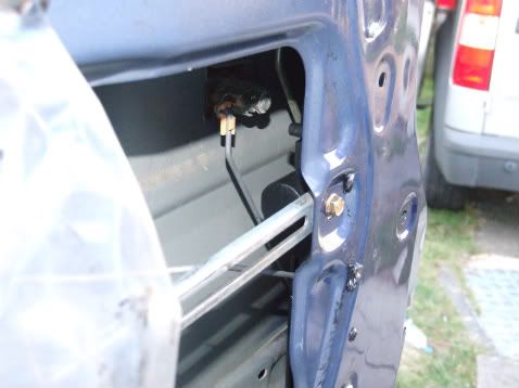

roosteruk
Re: Remote locking glitch...any ideas?
Post by roosteruk » Fri Jun 27, 2008 11:58 pm
2 piccies.
Position of solenoid and position of connecting block.
