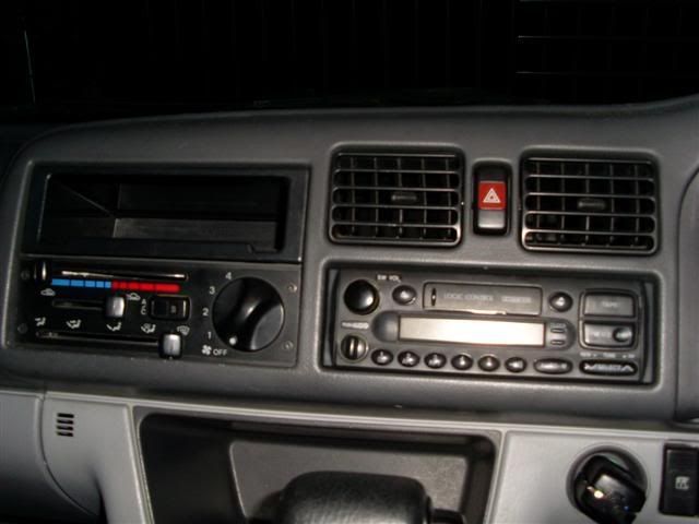

Whilst you have the radio out and tools in hand you might find this change helpful
I change radio more often than air and find the radio is a bit far away, also since I need a new radio/stereo I might as well put in one of those CD-less, USB, bluetooth stereos. For the hands free phone feature I would like the radio (mic) closer to the driver. Everything swaps/works OK except you need to get a slightly longer air direction cable, unfortunately Mazda used a different type of cable for this control, otherwise it would be a five minute job. On the plus side the required cable can be easily made from any suitable length of control cable.

God to see the manual heater control unit can be moved too
I swapped my digital control unit a while ago - not quite a 5 minute job, manipulating the looms into the right positions wasn't the easiest (few skinned knuckles
), but it seemed like a good idea at the time. Like you say Lev8. I fiddle with the stereo more than the a/c.

Re: Changing the stereo
Lev8
What a star
why didn't I think of that
Answers on a postcard or sealed envelope please
Guess what I'm doing this Sunday - might even get a new radio too
What a star
I like that!
It don't look out of place neither.
I've got a more labour saving option...
...I was blessed with the arms of a Gibbon, the only knuckle scraping is on the floor!
