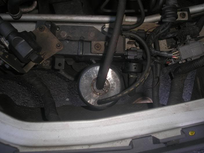

Prob not much help Hogman but i have the most annoying clicking noise on my v6 which i know atleast one other v6 forum owner has on his, i almost mistook it for a tappet or possibly a noisy fuel injector, but with more inspection turned out to be a solanoid on the fuel return to the carbon canister most do on cars it just old worn and more noticable cause if you got passenger window open :evil: it rite under the the pass seat :roll:
Anyway long shot i know but just maybe your noisy tappets on start are quietning down and your hearing is what i hear, which for some strange reason the only other person that can hear it is my 4 year old son, mainly cause he sits in the pass seat (OH AND EVERY PADESTRIAN I PASS :oops: :oops: :oops: )
but having said that mine only does it in drive, the clicking that is #-o
I hope you get it sorted cause the v6 really is a pleasure to drive,
ps i've noticed mine is noisy when when i got both seats up doin service, but sounds the dogs when revvvvvvvvvved up and seats down puuuuuuuuuuuuuuuuuuuuuuuuuurs like a cat :wink: :wink:

Can you hear it all the time hog or only when in drive and moving slow/ med speed :?: or is it constant tapping also when stationary :?: As to the camshaft im not that brave fella :roll: maybe would be if it wasn't my only way of getting to work #-o

Here you go Hog, this is my offending puppy :roll:
http://i59.photobucket.com/albums/g320/ ... 131622.jpg
http://i59.photobucket.com/albums/g320/ ... 131623.jpg
you can just make out the solinoid to the right of the carbon can. You'll know it when you see it.
Hope this is the answe to your prob [-o< [-o<
