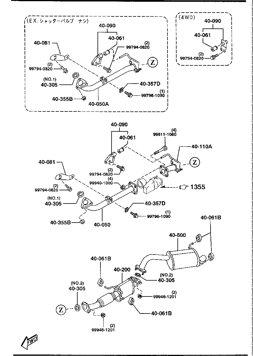

Piccy of the winter valve zorst.

Some bongo's have two starter batteries under the bonnet, this set up also has a switch next to the "rear" heater switch, with a picture of an engine on it, if clicked, the engine is warmed quicker in really cold conditions, by means of a valve/shutter/flap inside the exhaust... Mine doesn't have such a set-up. What i'm suggesting is that perhaps, the valve/shutter/flap section on your new replacement may have the extra section to cater for the "cold climate" bongo's,as well as the "standard" version.
It's hard to say without seeing the two exhausts lay out next to each other to compare...

Damn! I always forget about lushprojects!.... :roll: Cheers dandy.
