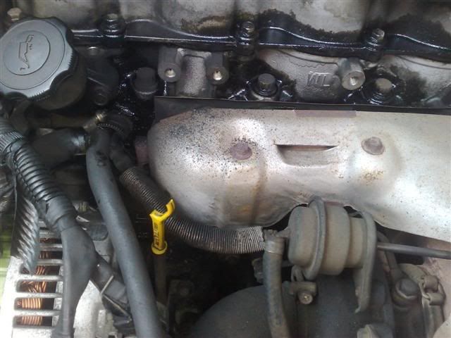

I believe I have the no.1 stud problem (squeels on starting or revving, fan belts seem tight enough), annoyingly it's taken a while to recognise this because it came shortly after changing the alternator...
I've just been to my local garage and shown them where the engine is (!) and asked for a rough idea of how much to extract and replace a broken stud. They would not commit, but said it would be somewher between 3 and 6 hours labour, and would entail removing the alternator, manifold and turbo. This doesn't sound like the way some people on here are suggesting it goes, are they ripping me off or just cautious?

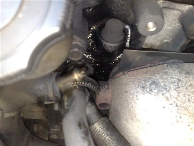

Also, I think they may have assumed that the missig stud is from the vacant hole visible by the left of the manifold heat shield in the first pic, is that it or is it further to the right under the shield? If so, it looks like it would be easier to get to..
Steve

I'm sorry to tell you mp3oplecarrier, but I think you have a more serious problem. :shock: From looking at the photos I see that your dipstick handle is broken..... :lol: sorry I could'nt resist.

...you've also got a bit of an oil leak around the rocker cover - you might want to get that looked at too. I had all my studs replaced last year at Bellhill, but can't recall the cost. I'm in the process of taking the head off & I would estimate it would take just under an hour to get the manifold off, probably the same to put back again. So 3hrs for the whole job would seem fair. Two things to check:
*Has the stud snapped or just come out? Two of mine came out the head when I undid the nuts, so you may be luck enough to just need a new one screwed in.
*If if has been blowing for a while, the gasket may be distored, so you should consider replacing that too (approx £20)
