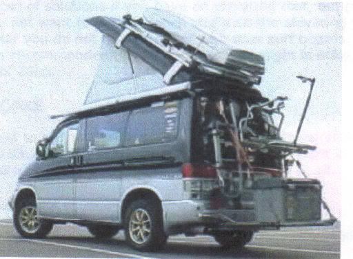

We use the kari-tek which has been modified with bespoke brackets by the previous owner. I think Rhod is probably using similar modifed brackets. They work a treat and as Rhod stated keep the profile down by keeping the rack close to the roof. The kari-tek takes some beating as if you've had a hard days paddle you don't really want to be lifting kayaks above your head onto a standard rack. Its not cheap but then a Rolls Royce never was! Hope this helps.

Wow Tim, that looks neat!. I've just bought a Perception Scooter sit-on-top kayak, so am keen to so how other folks transport theirs. I'd be a bit worried about having all that weight/drag on 4 tiny nuts glued into a plastic roof, but so far I've never heard of anyone's roofbars flying off at speed. Once her ladyship gets her kayak, then we'll have two to lug around.
