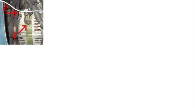

Am I right in thinking that you can adjust the tension of the belts, with the long bolt (1), then tighten the side bolt (2) to lock? :?

However, I was wanting to replace the belts whilst at it, but I just could not get the tensioner pulley for the air con belt to drop/slacken. I had the long bolt out, and tried to persuade the pulley to drop with a length of wood, a mallet, and plenty of WD40, but after a while I had to give up. I just left the original belts on, for now. :? Any ideas how to shift the b****y thing?

I've also put this on the other thread about changing the belts:
There is a large nut (poss 22mm) on the front side of the tensioner pulley. This clamps the pulley bearing to the slotted part. Unless you slacken this off, the long adjusting bolt will have no effect.
When I changed my alternator belts, I couldn't get the new aircon belt on as it was too tight, so ended up using the original

I did try that, it was a 17mm nut on the pulley wheel, but I could not get it to shift. I was trying it from above. I will be taking it to a garage tomorrow, for wheel balance test, as the steering wheel shakes at 65mph, so we are going to try to replace the belts then aswell.
