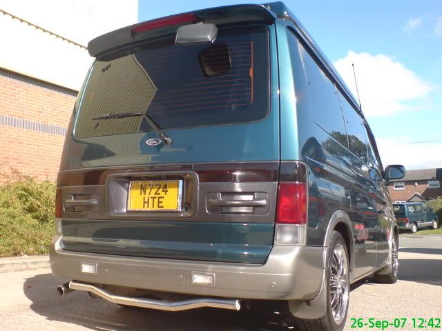

I have the flush rear fog type lights but with clear lenses...
http://i25.photobucket.com/albums/c97/j ... C00022.jpg
I simply carry a couple of red bulbs in the glovebox for fog conditions, or for the mot.
The clear versions seem to be quite tricky to source now, (i got mine from e-bay yonks ago)
I've had a few pm's over the months requesting info on em...
They are made by a company called "jokon" and are model number W3010.
