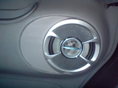

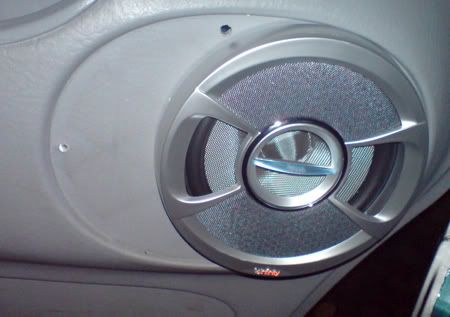

when i get the fronts all finished ill post some proper pics but for now you can kinda see how it sits. I went for 13cm infinity kappa comps up front after reading one of the posts on here saying that their kenwood 13's were a straight swap, thought it would be less hassle even though bigger would been better.
http://cgi.ebay.co.uk/ws/eBayISAPI.dll? ... :IT&ih=014
these are the ones i got but my EASY fit wasn't as straight forward as i thought, they didn't fit in the spacers as the magnets on the back are a funny square shape. instead i removed the spacer altogether and drilled the rivets out of the door cards. ive now fitted the new fronts directly to the door card, not too much hassle but it took my head a little while to work our a solution (it was cold and my brain wasn't working very well)
needs a tidy up but you can kinda see how it sits. i thouht silver would be more subtle than black on the grey....... i was wrong, looks a bit nasty to be honest but i got em now.

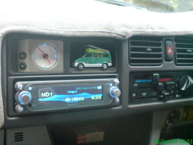

A high end Sony Explod reference type head unit...driving a Sony Explod 6 mini-disc changer in the glovebox...
I then fitted a pair of 6 inch Sony Explod mid range speakers behind the original front door speaker grilles,(hidden for security).
I fabricated a plastic shroud to help locate the speakers centrally.
Now the rear speakers, believe it or not, i managed to squeeze in some huge Kenwood 7x10's into the rear side panels!
I had to mark, the cut out the original speaker grilles which are bonded into place on the bongo,if you look on the rear of the panel, there are "plastic welds" that need to be drilled out,then the false speaker cover can be pushed out of the panel.
I removed the two rear standard speakers,plus the cages that house them to fit the new Kenwoods...

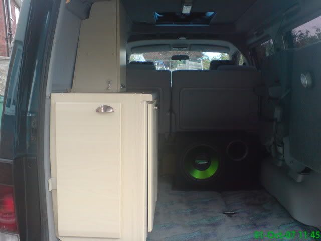

At the moment, the head unit drives the front door speakers, plus the 7x10's,this will be ammended over the winter as i have a nice 4channel sony amp to add to the fusion 2 channel amp that is currently driving the fusion 12" subwoofer.
Old pic.....
Current pic...
The 4 channel amp will drive the front speakers, and the 7x10's,the two channel amp (bridged) will remain for the sub, the four available channels remaining on the head unit will power some "tune up" tweeters in the front, and mid sections of the bongo. (when i get round to pulling all the panels off again

tidying up the fronts a bit with some thick card and a bit of grey leatherette/vinyl stuff i got off ebay. not quite right so i will probably redo it but i think it looks better than it did.
from this
to this
got the passenger side rear in, it was a bit tight so i cut the panel slighty differently on the drivers side to find that the speaker now fowls the metal panel behind. i will have to wait untill i can fabricate some mdf baffles for it now to pull it away from the panel (or relocate it and leave the big gaping hole that ive recently hacksawed out of the side)
from this
to this
