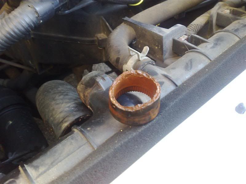

I've just found out why Mazda fit those awkward blooming hose clips rather than jubilees
I must have done it up too tight and broken an inch off the radiator outlet. I can't believe they made that out of plastic and that's going to cost me a radiator!

I think you will find most radiators have metal cores and plastic tops/bottoms these days.
Is there no way you can reshape the stub thats left or put a sleeve inside and bodge?? Must be someway round it.

You could try getting a piece of plastic pipe to fit inside the stub, use that to locate the broken piece and then stick the whole lot together with Araldite.
If you can't get exactly the right size get the next size up and split it lengthwise, gradually take plastic off the side of the split with a Stanley knife until when you squeeze it together, it just fits inside the stub.
The outward pressure from the spring of the plastic pipe will help hold it all together.
Then take it all apart, clean and roughen the outside of the pipe and the inside of the stub with emery paper and then smother inside of stub and outside of pipe with Araldite before reassembling the whole lot and binding it with gaffer tape to hold it together while it sets.
All you need to do afterwards is sand the outside smooth again and maybe, to play safe use, a bit of silicone sealant when you refit the hose.

Or I could just buy a new one.....
I found this:
http://cgi.ebay.co.uk/ws/eBayISAPI.dll? ... IF:GB:1123
I have to say I am impressed so far, next day delivery to my place of work and it is actually all metal with no stupid plastic pipes or tabs sticking out of it. I didn't manage to fit it tonight but I got the old one out at only the cost of most of the skin off my knuckles and oil from my gearbox!
