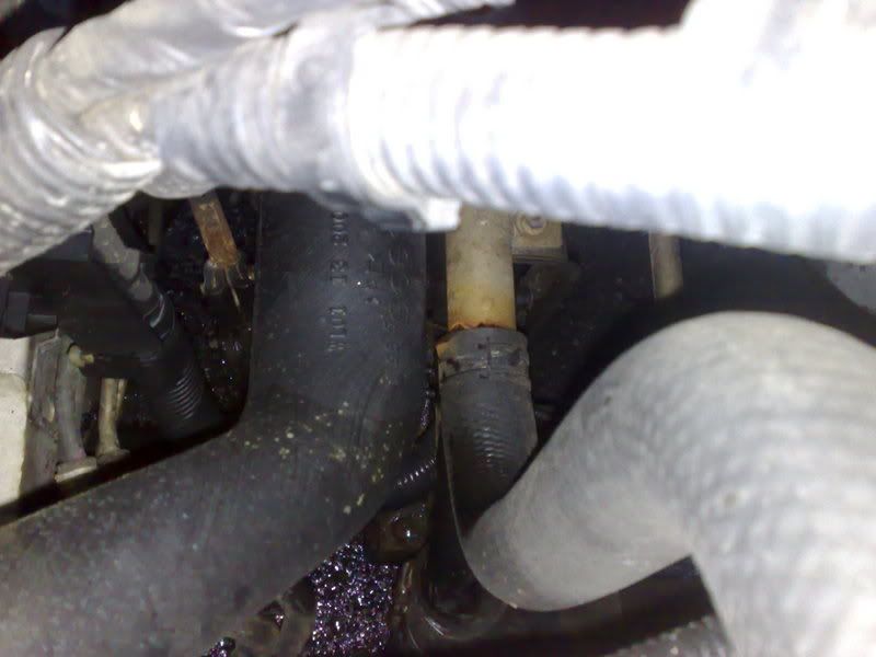

I got out of my car at the supermarket tonight and noticed the unmistakable smell of boiled engine, looked down and there were two brown rivers running away from the car.
When I looked under the bonnet it looked like there was a pinhole in the top hose near the end, squirting out a thin high pressure stream of water. I left it to it and went o do the shopping while it cooled down.
When I came back I put 2 litres of water in the expansion tank, which filled it to the top, I decided not to put any in the radiator as I was not sure about airlocks etc. I took the 2 mile trip home very easy, but when I parked up I could see that there was a line of drips following me.
I took this picture of the hose while it was squirting:
And on looking at it at home it looks like the hose has slipped off the pipe judging by the discolouration showing on the pipe.
My questions are,
do you think that the leak was just coming out the end of a loose pipe? Will I get away with just pushing it further up the pipe and retightening the clip?
Will I have cooked my engine?
Do I have to dig out the bleed procedure?

Its allways dificult to tell from pictures but if you saw a spout of water best get a new hose.
once fitted follow the fact sheets on bleeding and hope for the best if you have done any lasting damage ie cracked head it will show.
have you killed it, no
however its worth finding out why it moved is there a blockage causing too much pressure? maybe worth getting the rad checked.
low coolan't level warning would have helped here

I don't think you have done any harm. However you must... Sort out the leak and bleed it. I would put a new hose on and check the metal pipe is not rusted through. If it is (common) I think Bell Hill Garage Will have one.. I would then check the "other "top hose that runs to the engine from the other end of that metal pipe.
If you had invested in a coolant alarm kit this would have warned you you were loseing coolant after about half a cupful was lost. Ithink you have been lucky.. Whatever you do ...when fixed bleed the system correctly.
Check all hoses large and small.

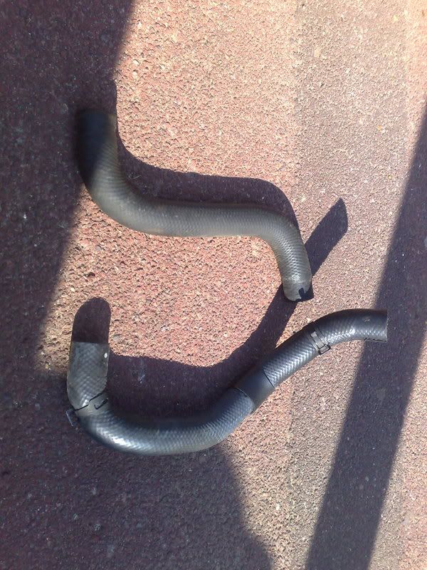

The top hose I ordered off ebay seemed a different shape, but I shrugged my shoulders and attempted to fit it, onlyy to find it was not the right one :( . I have informed my supplier who is looking into it, but perhaps somebody could take a look and confirm my suspicions?
The original is the 'S' shaped one. I have refitted this at the moment, I trimmed the end that was leaking and made sure that everything was pulled on tight, but there was still a slight leak when the pressure was beginning to rise (temp guage reaching the top of the 'C'). I have decided that this is down to the spring clip, so have bougt a good honest jubilee clip today to try first thing tomorrow.
