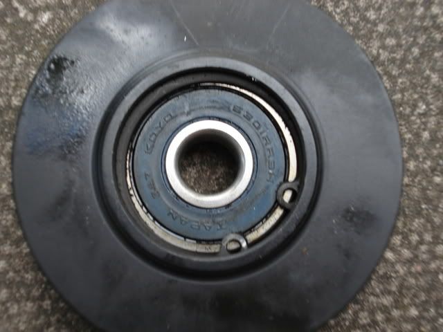

This is what I have found.
Doesn’t seem to be manifold stud problem
There is some seepage from the inlet manifold of the black sludgy stuff.
Took the alternator belt off, there is a little bit of play in the water pump bearing (seems worse as you rotate the pulley a few degrees). But no water leaks from pump.
But a LOT of play in the air con belt adjuster pulley, is this normal?
Where can I get a new pulley from?
Any advice would be greatly appreciated.
Thanks in advance.
I am beginning to think that the air con belt adjuster pulley is not the problem, as the bearing is held in just with a circlip, so probably will tend to float about to some extent - am I right?

Thanks for the advice. I have put it all back totogether for now, will order a bearing and pump and change them next weekend if it's not raining!
Anything other likely suspects to check out whilst i'm doing it?

Post by Allans » Sun Jul 08, 2007 4:18 pm
Your description of the noise sounds like the start of a water pump problem, but I'm just guessing, I could be wrong. It's tricky to describe a noise. :)
