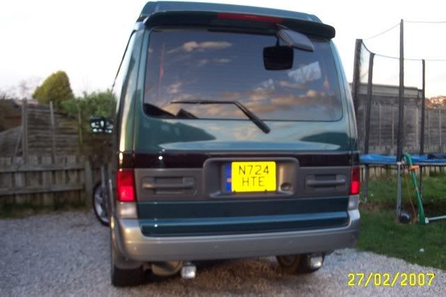

Hi Franco,
yes you will need a rear foglight(s) of one kind or another to see you through the m.o.t.
I suspect you had a "dangly" fitted at some stage, and these are notoriously easy to snap off :roll: (usually when the cable at the jetwash gets wrapped around it)
You will probably discover that the cables have been taped up out of the way in a hurry,and the bare ends of the cables are touching each other, or,the power cable may be taped to the body of the bongo underneath :shock: That'll explain the electrical short when you hit the switch.

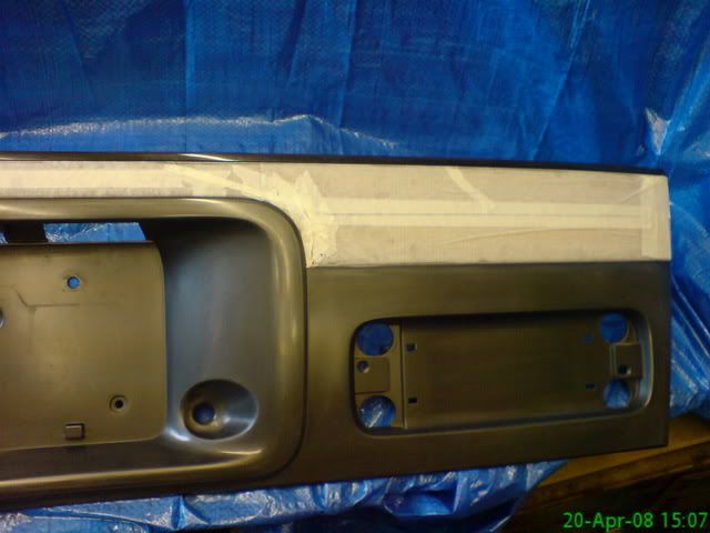

I changed the "danglies" to these neater flush fitting items.
(my fogs are used as extra reverse lights 99% of the time,i keep red bulbs in the glovebox for m.o.t's etc.)
