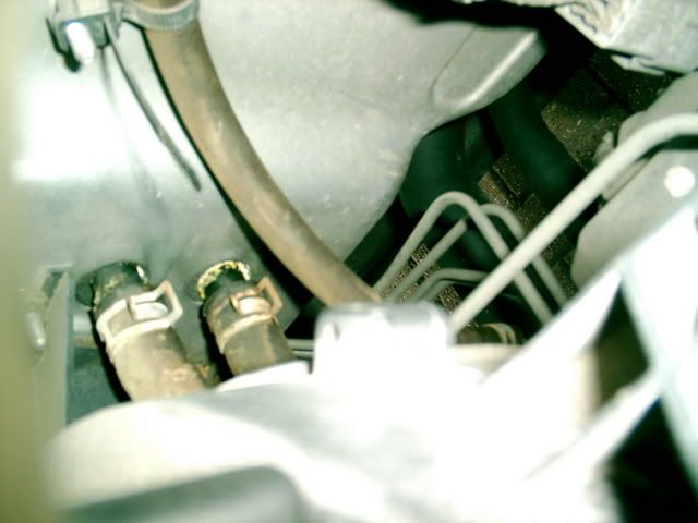

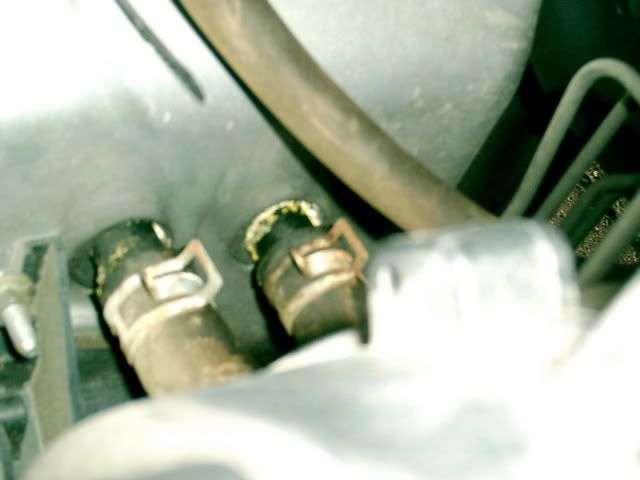

After reading all the threads about overheating and the complicated cooling system I decided to give mine a good look over. All looks ok apart from the two hoses to the front heater where there is a white crusty substance around the hoses. So is this the start of a leak? :?

looks like a small amount has seaked out at some point, is your coolant level staying constant?

yes Pretty much I top up a small amount every 2-3 months, and the needle sits rock steady at 11.30.

Worry not then :wink: just monitor as you are doing, these overheating threads do cause concern, but the plus side is that members are made aware of correct coolant quality, levels etc, do a coolant change every 2 years, bleed the system, replace jaded hoses and caps as need arises and you will be fine :wink:

Thanks for your advice :D , I think I will changing the hose clips with some good old jubilee clips just as a precaution. :)

Thats what I have done, jubilee clips are much more user friendly--stay cool :wink:
