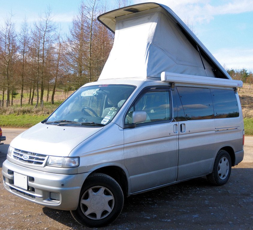

You do have a Mazda Bongo Friendee ?
If so which engine type ?

Mine, bottom photo is a 2.5 diesel (2001 plate)

Definitely a Bongo! :lol:
