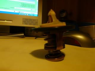

Post by haydn callow » Fri Nov 06, 2009 10:41 pm
Woooop's gonna think again...photo's to follow
Imagethat's my stat removed last week...It fell out and I don't remember which way round it was for sure....the new one would only go one way.
However...I think it goes the way it is in the photo.....co's...there is a white limescale deposit all over the top surface and the bottom below the seal is clean brass.....that is what I would expect if it sits as in the photo

Post by Doone » Fri Nov 06, 2009 10:54 pm
Can anybody postively confirm the pointy end of the thermostat points down into the thermostat cover?
Where's Allan when you need him ???......give him a dig Doone !!! Thanks
He's home now. :D I have asked him about the thermostat and he said the pointy end points down.
The disc end goes up into the thermostat housing.
There's a 'lump' on the rubber seal of the thermostat and this points towards the drivers door.
Haydn, that must mean that it's upside down in your photo, as you have stood it on its flatter end. :)

Post by widdowson2008 » Sat Nov 07, 2009 8:29 am
So the Japs did get it right in their diagram after all. :D
