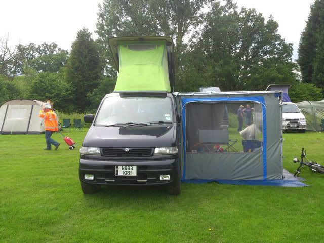

Here is what I fitted, the 255 version.
http://www.fiammastore.com/Caravan-Awni ... ing-Canopy
Remove the original 3 hooks and fit an awning rail under the AFT using self tappers and some kind of bonding/sealing stuff, I used Sikaflex.
The awning bag just slides onto the rail. I looked at the 2.8 but thought it may be a bit long as the roof curves at the front. The 2.55 is big enough as it comes out quite far. I got some sides and front off ebay and modified them to fit and it is weather proof.
To wind it out you just undo the zip and roll it out. The legs are stored in the tube. I can do it easily by myself but is easier with 2. Takes about 5 mins to set up inc. putting the sides on. I can take more pics at the weekend if required.
