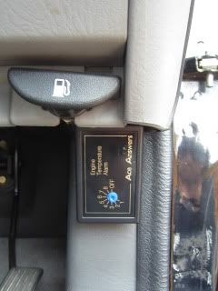

Just as a curiosity... Have you ever had a slight start up pip sound from your Mason alarm with the ignition, prior to your over heating/top hose leak episode???
(Yours was a bit too big to load up on the forum, so illustrated with mine!) :wink:
Don't shoot me down guys.... :P But this looks relatively normal to me!

1/2 tank of diesel looks normal to me :roll: :wink:
Mine has always had a start up pip.
Assume that's to let you know it's ( Mason ) properly connected and working.
My temp gauge has never gone that high even doing 70 up hills.
Or sat in traffic.
Usually max 3/4s across. OK not too different looking again.
Mine has a new rad and stat so if yours doesn't ( jaylee ) that might explain the slight difference.

skater wrote:1/2 tank of diesel looks normal to me :roll: :wink:
Or sat in traffic.
Mine does sit lower in traffic with no fans kicking in... Had the pump & stat done plus new hoses.. Did have this scare a while back.. http://www.igmaynard.co.uk/bongo/forum/ ... +detective
I did read a long time ago that sometimes a false alarm on the mason is indicative of an impending alternator failure.. Or possible battery problem..?? :-k
The reason i asked xxchefxx is maybe the mason was not connected properly & was running on damped..?? possibly by sheer fluke it works now & looks like it's running too hot!?? Yeah there was a leak on the top hose, moving the Mason like this http://i205.photobucket.com/albums/bb13 ... photo1.jpg & tugging at the loom may have reconnected it??
Your right though, the rad is gonna be next on my list... :wink:
