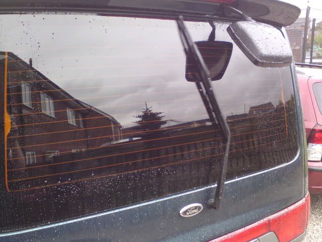

mikexgough wrote:Image
Mazda Demio wiper.....
http://translate.googleusercontent.com/ ... OKXEX7O3Cg
Well spotted as usual Mike! Gotta get me some of that! :D
My rear arm is the standard bongo item, with a moulded "aero" blade from a MK5 Ford fiesta, this fits with a small amount of modification, and looks a bit more modern than the standard bongo blade. The entire Fiesta blade & ARM fits, but won't tighten as the hole in the wiper arm has a larger hole, thus doesn't grip the wiper motor spindle when the securing nut is tightened.

Post by Doone » Sun Jan 24, 2010 9:20 pm
Sweet isn't it. 8)
