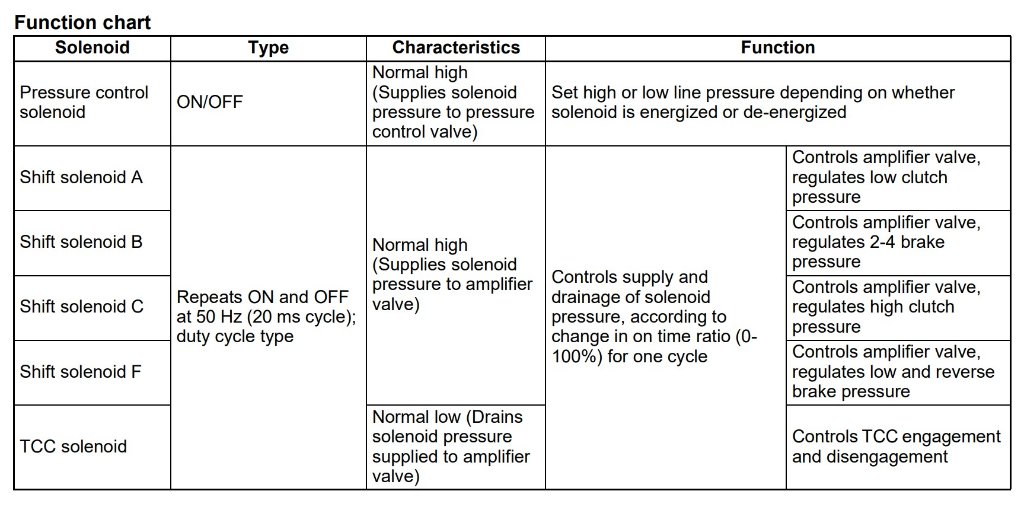

A meter isn't going to be of any use its a pulsed system and its the % of the duty cycle that determines the position, its pulsed at 50Hz and the On period compared to the Off period that determines the selection;

g8dhe wrote: Sat Feb 08, 2025 4:09 pm A meter isn't going to be of any use its a pulsed system and its the % of the duty cycle that determines the position, its pulsed at 50Hz and the On period compared to the Off period that determines the selection;
I have a scope too. I just have no idea where to probe.
When it wants to activate a solenoid it goes from ~0% to ~100% to make a smooth change or something?
Thanks.
