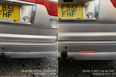

I changed the after market dangly one for a Hella flush fit into the rear bumper. Looks nicer in my opinion. Has been on three years and like new inside.

I've done the above. When we got the bongo it has one that dangled underneath, this caught a curb and broke off, so I bought a replacement. When fitting, I found there are multiple mounting holes or broken mounts where previous ones had done the same! I fitted it anyway, when it came to the next MOT, it failed as it didn't have a rear fog. I hadn't noticed it has been knocked off again!
So that time I put a red bulb in the OS reversing light and moved the wire up to power that. It has been like that for years since. If I'm honest I was never happy with the bulb as it looked pink but it kept pushing until last year when they said it was too pink. So I put an extremely bright red LED light in instead and now it looks great very happy with it and passed straight off on the MOT.
So much neater and works so well!, Costs a few quid for the bulb and a little bit of time.
