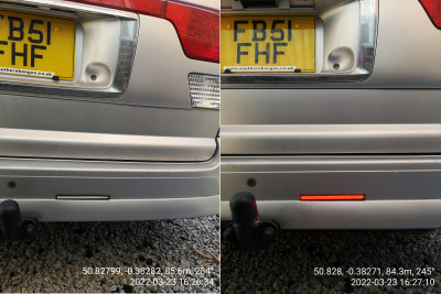

A lot of converters are using the stick on RED COB led strip panels now https://www.ebay.co.uk/itm/185345265302 ;

g8dhe wrote: Thu Jun 02, 2022 3:39 pm A lot of converters are using the stick on RED COB led strip panels now https://www.ebay.co.uk/itm/185345265302 ;
I'll get one of those for next year, this hang off the bumper one will be this years offering, cheers for the headsup.
