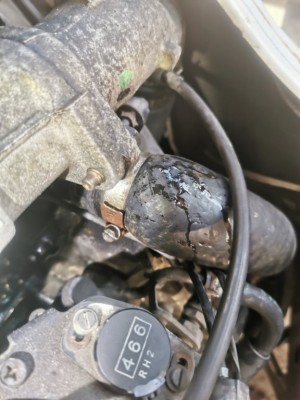

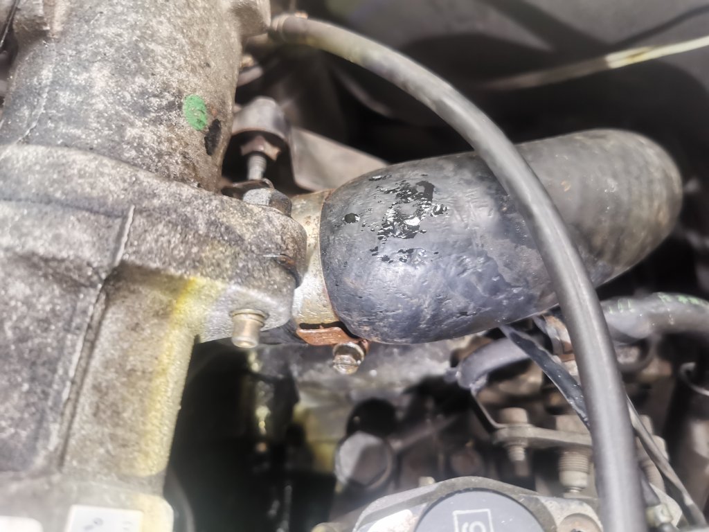

Nope, that wasn't causing it. :roll:
Turns out I need to replace the top engine coolant hose.
I thought the clip was possibly loose and causing the leak so I put a jubilee clip outside it and wiped everything down to see if the problem persisted.
When the engine warms up the hose bulges and the coolant comes out of the pipe through these tiny little pin holes, I can't even see them when I wipe it off but the coolant is certainly coming from there.

So I'm after taking out and replacing the top engine coolant hose.
Can someone explain to me why the water in the radiator didn't flow out?
I'm ready to start the bleeding process but I'm just wondering how removing this pipe didn't empty the radiator :?

Because it feeds the top of the radiator, from the top of the engine?

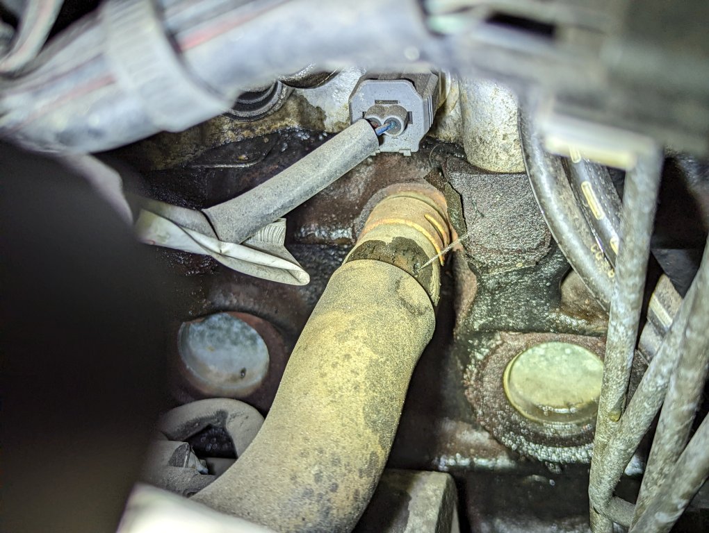

Right so...
Round 2, let's go :lol:

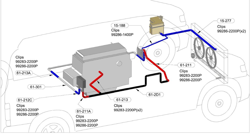

HArd to see in the picture is that the hose or what it clamps onto?
Posts: 10884
Re: Can someone identify the part I need replaced? (2.5TD Coolant system)
Post by g8dhe » Wed Nov 16, 2022 10:57 pm

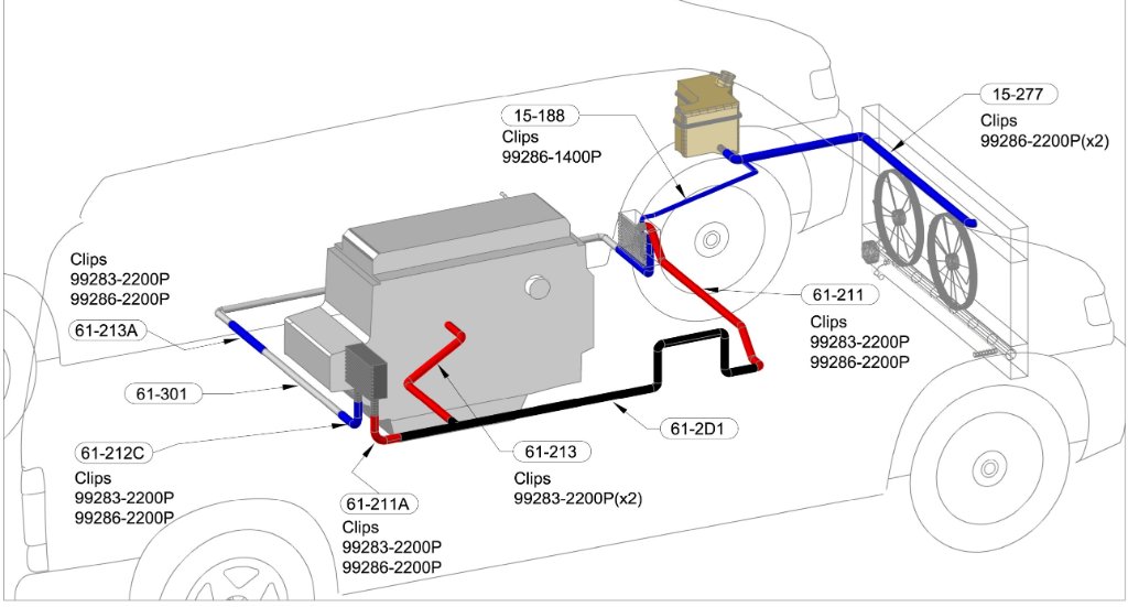

Maybe 61-213 ?

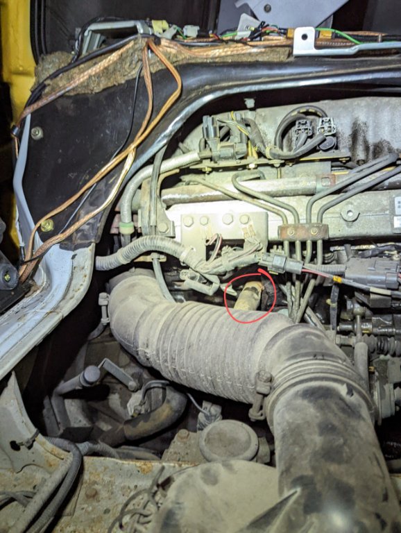

Post by Northern Bongolow » Thu Nov 17, 2022 5:20 pm
Over the starter motor pipe. Check the other end where it clips to the heater system it rots away

Alkers wrote: Wed Nov 16, 2022 9:29 pm HArd to see in the picture is that the hose or what it clamps onto?
Hi Alkers, yea it's actually the hose, that particular one has a double layer on part of it to protect it.
g8dhe wrote: Wed Nov 16, 2022 10:57 pm Maybe 61-213 ?
Thanks g8dhe, that's exactly what it was =D>
Northern Bongolow wrote: Thu Nov 17, 2022 5:20 pm Over the starter motor pipe. Check the other end where it clips to the heater system it rots away
Looks okay at the other side, replacement pipe is on the way should have it during the week.
